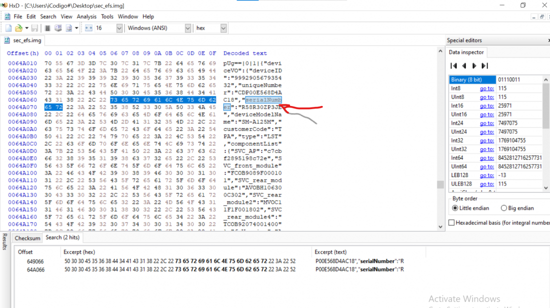

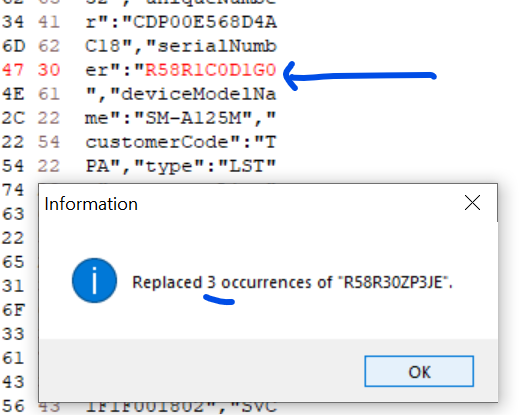

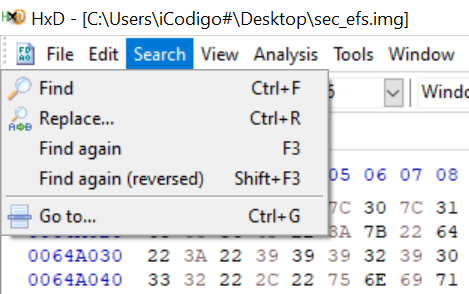

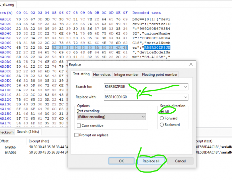

Sure, I just confirmed that it's mandatory : IMEI and samsung Serial number have to be changed, otherwise, sooner or later it'll relock. After flashing rpmb from special particions, it has to be imei and samsung serial number replaced. In case that you have any doubts about how to change samsung SN. Firstly with chimera tool ( idk if there is another tool for it), after TP, backup sec_efs partition > unzip it, it'll give you a sec_efs.img and open with any Hexadecimal editor> find "Serialnumber"> you'll see something like : RZ8R715LH0N> COPY and paste sticky note> use anyone different " I use R58R1C0D1G0" or edited it (it doesn't matter, as long as it has 11 caracters numbers and letter)> Go to Search and replace option> find the original SN and replace for your new one.> Note : select all and replace all> done. now close and save it. > zip it back with a .zip> and restore it with chimera to the phone.
So, now it will have a new serial number.
