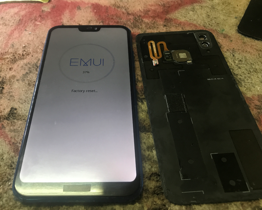

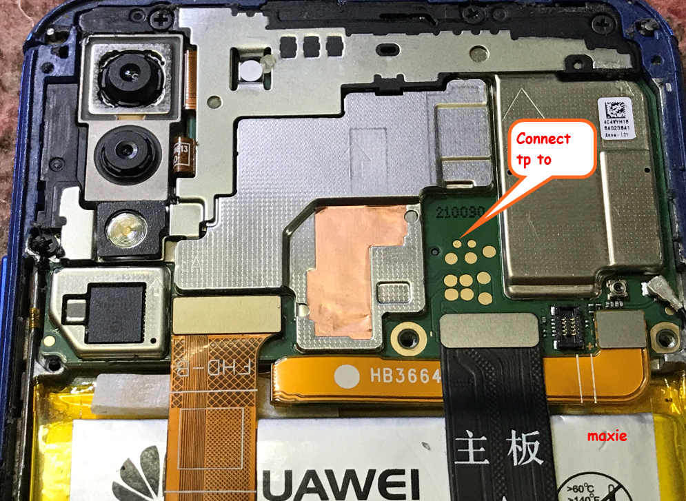

Problem : Google account or FRP
Solution : Unlock Via TP
Log
[USB 1.0] ERASE FRP Scanning port... COM40
Connecting to port... OK
Connection : USB 1.0 Full-Speed
USB Driver : [HUAWEI Incorporated] HSPL_usbvcom
Selected Model : HiSilicon Kirin 659 [Unlocked]
Code Name : Hi659
Operation : Kirin Testpoint
Authenticating... OK
Retrieving data... OK
Platform : HiSilicon Kirin 659
Writing sec_usb_xloader... OK 0.489s
Writing sec_fastboot... OK 24.949s
Waiting for fastboot... OK
Product Model : ANE-LX1
Erasing FRP... OK
UNLOCKTOOL v2020.12.31.0
Elapsed time : 37 seconds
Test point
